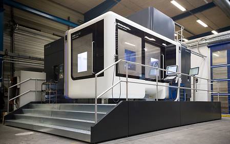

The robust rotary table of the DMU 210 FD can accommodate parts up to 1.850 mm in diameter and 5.000 kg.

The machine has a portal design for the highest precision and dynamics up to 3m/s2.
In their line of work the batch sizes are quite small, sometimes just a single piece, so there is absolutely no room for error. All the parts they are producing have to be perfectly functional in order to be profitable. This sets extremely high requirements for both the human workforce and the machine park as well. For more than 10 years JB Production has been relying on DMG MORI machines to stay ahead of the competition and set new standards in its region. Their latest investment, a DMU 210 FD universal 5-axis machining center serves exactly this purpose by enabling the company to manufacture bigger components, work more efficiently and realize even the tightest tolerances thanks to the integrated grinding functions.
JB Production AS
With 44 kW power and 10.000 RPM on the main spindle, the machine is well equipped to cut even the hardest exotic materials.

DMU 210 FD 5-axis universal machining center with integrated grinding functions.
The tools are stored in a chain type tool magazine. Kurt Andersen explains that they have chosen a version with 120 stations because this way they can store all of their standard tools in the machine – around 80-90 standard milling and turning tools plus the grinding wheels – and they would only need to replace special tools for unique jobs. Kurt Andersen also adds: “The tool magazine can be accessed at any time, so the operator can manage the tools even while a program is running. There is also a second CNC interface here that allows him to constantly monitor the machining process and even stop the machine or issue any command that is necessary.”
