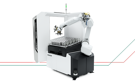

Robo2Go by DMG MORI
  • Easy programming via CELOS
  • High acceptance by modern working enviroment - Fenceless system with ergonomic access to the machine
  • Easy teach-in functions for different work pieces
  • Flexible setup at multiple turning machines
Technical data
Maximum workpiece weight (kg)
Maximum pallet/workpiece size (mm)
Robo2Go
10kg
5
Ø100x250
Robo2Go
20kg
12
Ø135x250
Robo2Go
35kg
22
Ø175x250
Machines
Robo2Go 10kg is available for: CTX alpha 300, CTX alpha 500, CTX beta 500 / 800 / 1250, CTX beta 800 TC / 1250 TC
Robo2Go 20kg is available for: CTX alpha 500, CTX beta 500 / 800 / 1250, CTX beta 800 TC / 1250 TC
Robo2Go 35kg is available for: CTX beta 500 / 800 / 1250, CTX beta 800 TC / 1250 TC
