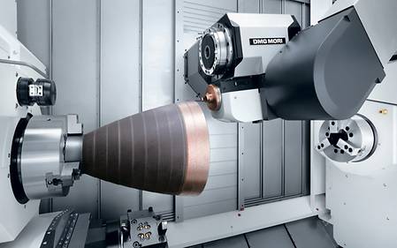

Flexibility by the combination of additive and turning machining process for 3D-parts in finished quality
  • Large parts up to Ø 660 mm, 660 mm in Z (axial) or up to Ø 545 mm, 1,500 mm in Z (radial)
  • 5-axis material deposition by coaxial nozzle for homogeneous powder distribution, independent from direction of laser deposition welding
  • Additive Manufacturing of metals and reactive materials such as Ti-6Al-4V (optional)
Process monitoring and adaptive process-control (Closed Loop)
  • User friendly and specifically developed software with operator-orientated user interface and CELOS integration
  • Process monitoring for highest process safety and quality management
  • Continuous measuring and monitoring of the laser buildup process as well as automatic regulation of the laser power in real-time for homogeneous part qualities
  • One software package for the complete process chain (design, additive process, substractive machining,  finishing)
  • Exclusive LASERTEC build-up strategies - fully integrated in the CAD / CAM software incl. 3D-simulation of machine and movements for collision prevention
  • Shorter time-to-market due to completete integrated PLM software integration
Completely new product design potential
  • 5-axis controlled laser deposition welding in machining centers makes new products possible
  • New part featurespossible due to alternating material deposition and machining strategies
  • Improved part performance through new material combinations (e.g. Copper + Inconel)
  • Parts with inner channels for innovative, improved cooling
