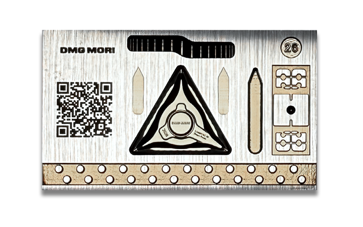

TECHNOLOGY: LASERTEC Shape Femto
Industry: Die & Mold
Material: CF-H40s (Tungsten Carbide)
Dimension: 15 x 25 x 2 mm
Cycle Time: 1h 32 min
Benefits
Themed image
  • Contact-free laser machining without tool wear
  • Femtosecond laser for “cold“ and slag free ablation with surface finishes of Ra ≤ 0.1 µm
  • Machinability of Advanced Materials (tungsten carbide, ceramics, PCD …)
  • 24/7 automation with PH 50
