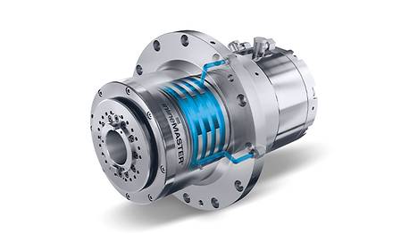

NEW: inlineMASTER SPINDLE FOR THE CMX V AND CMX U WITH 36-MONTH WARRANTY
HIGHLIGHTS
- Proven DMG MORI quality with MASTER spindles
- Available for all CMX V and U machines
- 12,000 rpm inlineMASTER spindle with 83 Nm and 13 kW (optional)
- 15,000 rpm inlineMASTER spindle with 121 Nm and 20 kW (optional)
- 36-month warranty on all MASTER spindles with unlimited spindle hours
- Better cutting performance due to 53 % higher spindle power and 45 % higher torque with the 15,000 rpm inlineMASTER (20 kW, 121 Nm at 40 % DC)
- 25 % faster spindle speed for improved surface quality
- BIG PLUS® interface for longer tool service life: Elimination of Z-axis movement at high rotational speeds due to face contact
- Oil / air lubrication of the spindle bearing and improved ribbed structure for long service life
- Liquid cooling for optimum thermal stability
